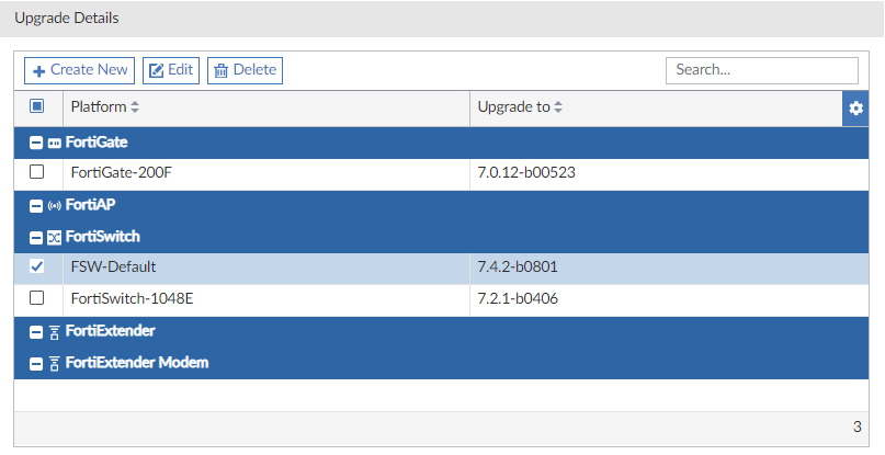

We are on latest FMG (74.2), and there you find it under:
Device Manager: Firmware Templates:
You can then schedule the template run run as desired, or run it manually.

If you manually upgrade a device, Manager will just update the status when it comes back online. It does not break anything, but is simply a more slow process, but you are in detailed control.
You can do the 'manual' upgrade of a single device, either on the devices own interface, that requires you manually download the FW from Fortinet, or you can select it in the Switch Manager part of Manager and initiate a manual update from there, selecting the desired FW version.
If you run a FW Template on a group of devices, Manager will show you what devices needs updates, and let you initiate that process.
