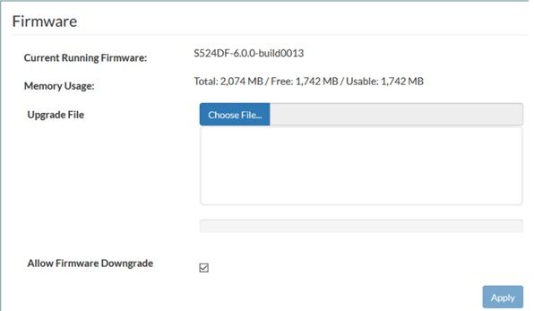

When I open the Firmware upgrade page via GUI it is just blank. It does not look like this:
It is just blank.
The current firmware is: v7.2.3 build0434 221212 (GA)
It is connected to a Fortigate but the mode is standalone.
Does anyone of you know why the website stays just blank instead giving me the website like shown in the picture above?

We have solved it. We have updated the Switch to Version v7.2.5,build0453,230707 (GA) via cli by using a tfp server. Thanks to this article: Technical Note: Upgrading FortiSwitch Firmware
After the update the webpage is loading perfectly. So I think it is/was a bug in version v7.2.3 build0434 221212 (GA).
