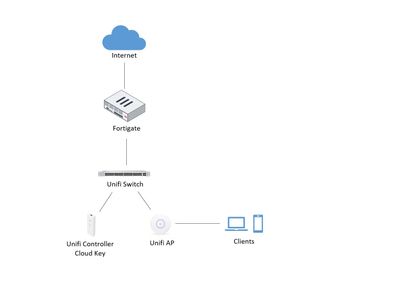

Greetings,
I should configure a WiFi SSID on a UniFi Controller that performs redirects to a Captive Portal on a FortiGate so that the users are picked up by a FortiAuthenticator.
In particular:
It can be done?
If that's not possible, I was thinking about:
Thank you very much for helping.
Solved! Go to Solution.

Does the Captive Portal appear automatically or does the user have to open a browser?
Mainly users will be connected with Smartphones, which is why I would have preferred Unifi to do Radius redirects or similar for the captive portal on FortiGate.
anyway thanks so much for the reply
FG portal doesn't open automatically, user has to open browser and type an address.
Since the user already authenticates with RADIUS I think you can use RSSO instead of using captive portal. Please check here if it is what you want.

Hi Aek,
I made the necessary configurations temporarily using a Huawei AP.
I configured a VLAN Interface on the FortiGate and created a SSID on the Huawei Access Point without a password.
Immediately after connecting to the SSID, the FortiGate Captive Portal is automatically opened and by entering the credentials taken from the FortiAuthenticator everything works.
I set the timeout to 24 hours and even logging out and logging back in after a few minutes everything works fine.
Thank you so much for your help, you were very kind!
