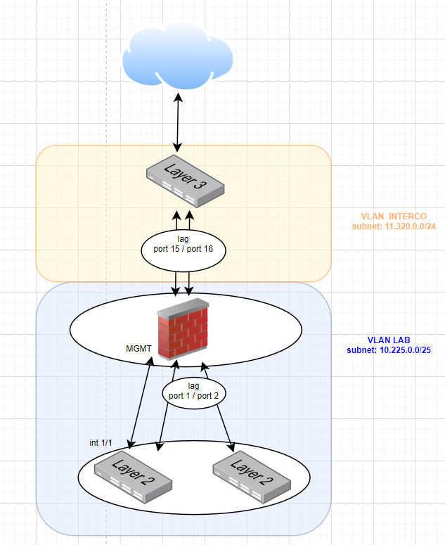

I have tried to change the address of my mgmt interface so it is not in any of my subnet anymore. I still cannot access it but the material below is still pingable from my network (the cloud image). I hope the scheme will help you understand my problem a bit more, I tried to use the dedicated management interface reservation but it doesn't seem to change anything. I also tried to use the diagnose sniffer packet command and it seems that I receive request but doesn't send a reply.
Thanks in advance

can you share some output/commands for more info ?
diagnose debug enable
diagnose debug flow filter saddr SRCIP
diagnose debug flow filter daddr MGMTIP
diagnose debug flow show function-name enable
diagnose debug flow trace start 100
to stop:
diagnose debug flow trace stop
diag debug disable
start those and try to connect to it, then post the output here, please.
also:
get router info routing-table details SRCIP
and the firewall policy for: srcintf LAG(port15-16) and dstintf mgmt
show firewall policy ID
