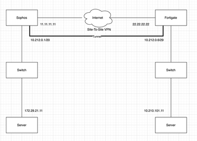

I have 2 offices, Site A is Sophos and Site B is Fortigate. I have established Site-To-Site VPN for the two sites. The tunnel between the two sites is UP, but the Tunnel Interface IP cannot ping each other and the two sites cannot ping each other. The server under the site cannot ping the opposite endpoint.
The following is relevant information:
Site A (Sophos)
  • WAN IP : 11.11.11.11
  • LAN IP Subnet : 172.29.21.0/24, Server IP: 172.29.21.11 (LAN Gateway under Sophos Firewall)
  • Tunnel Interface IP : 10.212.0.1/29
  • Firewall Policy: Accept LAN(172.29.21.0/24) toVPN(10.210.101.0/24)
Site B (Fortigate)
  • WAN IP : 22.22.22.22
  • LAN IP Subnet : 10.210.101.0/24, Server IP: 10.210.101.11 (LAN Gateway under Fortigate Firewall)
  • Tunnel Interface IP : 10.212.0.6/29
  • Static Route: 172.29.21.0/24 via interface S2S_DCOF_M
  • Firewall Policy: Accept LAN(10.210.101.0/24) to S2S_DCOF_M(172.29.21.0/24)

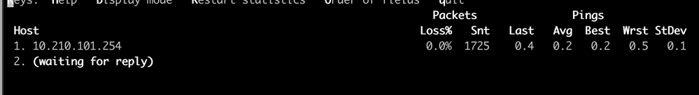

and i tried the mtr from server, according to the server's mtr tracking, the data will stop at Fortigate's LAN Gateway
