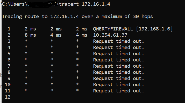

Tracert from LAN (On-Prem)

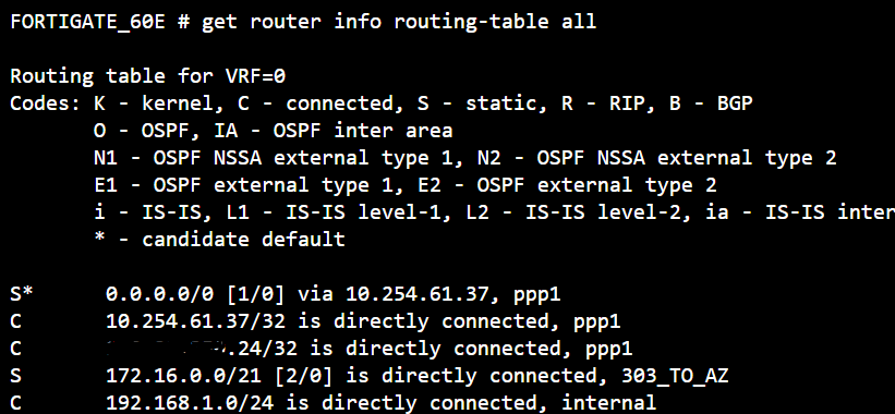

What do your route-tables look like in both Azure and on the FTG?
Here: Fortinet routing table.

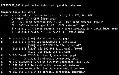

Please give us the output from the below command.
FW # get router info routing-table database
Here:
Everything looks good on the Fortigate. If you can take a screen shot of the route-table(s) on the Azure side that would work. It could be your not propagating the routes to the vNET from the VNG. By default, the VNG will route RFC1918 back down the S-2-S tunnel so if there is no route for the destination subnet in the VNG route-table it will not reach any host that resides there.
