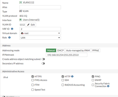

ok, i tried VRFs.
Enable advanced routing feature
Enabled overlapping subnets
set allow-subnet-overlap enable
And managed to created two different VLANS with different VRF's and same primary IP's, it allowed me to do that only after i enabled overlapping subnets.
VLAN1111
VRF ID: 1
Primary subnet: 192.168.10.254/255.255.255.0
Secondary subnet: 192.168.11.254/255.255.255.0
VLAN1112
VRF ID: 2
But i tried to add a secondary overlapping subnet 192.168.11.254/255.255.255.0 in VLAN112 and it didn't allowed me to do so.
So overlapping subnets only possible for primary VLAN subnet ?
My goal was create two VLANS with different VRF's and with same primary and secondary subnets for each engineer.
