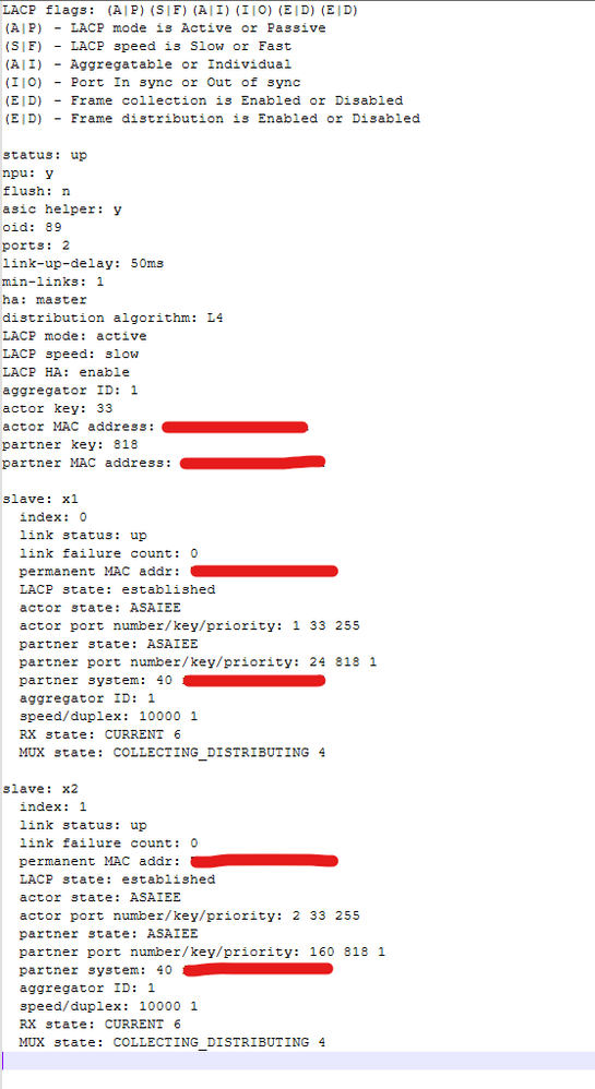

I have two FG201F FortiGate devices connected via an IPsec tunnel, both running firmware version 7.0.15. The latency between the two FortiGates is approximately 17ms. The VPN's are configured in an SDWAN.
Here is the problem:
Server-A, located behind FG-A, needs to communicate with Server-B, which is located behind FG-B. FG-B uses an aggregated port combining interfaces X1 and X2, both of which are 10GB interfaces.
When Server-A communicates with Server-B through the aggregated interface, the connection speed is only 20-30 Mbps. However, if I move the VLAN of Server-B to a non-aggregated port, such as Port 2 (which is a 1GB interface), the traffic speed increases significantly to 600-800 Mbps.
Both interfaces are connected to a Dell N4032F stacked with an N4032. On the switch, the configuration is a simple port channel in active mode.
It's noteworthy that if you connect from a server behind Port 2 (FG-B) to the VLAN behind the aggregated interface (also FG-B), you nearly achieve the full 1GB bandwidth.
Any idea what i did wrong?
The Problem must be a combination of the WAN Interface and the LACP but i cant figure out why.
I ruled the S2S VPN already out since it is working with the non LACP Port.
Below the netlink diag

Hi,
Your problem sounds like a issue that should of been solved in 7.0.15 ( 910829 , https://docs.fortinet.com/document/fortigate/7.0.15/fortios-release-notes/289806/resolved-issues ) and in 7.2.8 .
If you have a active support contract, I would suggest opening a TAC case for this.
