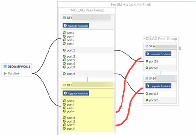

I have a problem with one setup and I don't have any idea why links between switches are down
Those two red link are missed from fortilink. on lest switch ports 25 and 26 are connected , on right 17 on both.
Led not blinking. SFP modules replaced, fibers also. But what is really weird if I put ports 25 and 26 on left top, right switches are still online
I don't have any idea why those two links are not working. Tried also setup speed on left to auto, 1000auto,1000full, nothing help.
Tried also connect another forthiswitch to port 25 but still the same. on this switch led are not blinking but on second switch link is up and led are on.
Transceivers are recognized correctly
Any ideas how to troubleshoot . Black scenario is reset left to factory and reconfigure again .
Models
Left 224D
Right_ 424E-Fiber
FortiOS 7.2.4
Fortigate OS 6.4.14

Regarding your issue, I didn't try connect MLAG to MLAG before, but I think it is normal behavior to prevent loop.
Try remove connections from top left switch to right switches, just to see if the connections with bottom left come up.

Regrading MCLAG-MCLAG connection it is typical Multi-tier MCLAG architecture, I have few locations configured lite this, so I think it is not the issue in this case,

OK, We worked on this topic few hours , and we didn't found solution. Only one helped. Issue fixed by factory reset left bottom switch. Then link come up. Maybe some misconfiguration in switch or FG. Also this switch has been removed from FortiGate and re-joined. Now is fine
