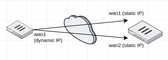

In my case I need a redundant dial-up VPN from branch office FG to HQ FG, where HQ FG has 2 WAN in a SD-WAN zone.
A "classic" setup didn't work, I see the tunnels flapping from the first to the second and vice versa.
When configuring one tunnel (A or B) it works well, but enabling the two seems problematic.
Didn't troubleshoot deeper so far, so I don't know the root cause yet.
Any advice would be appreciated?
