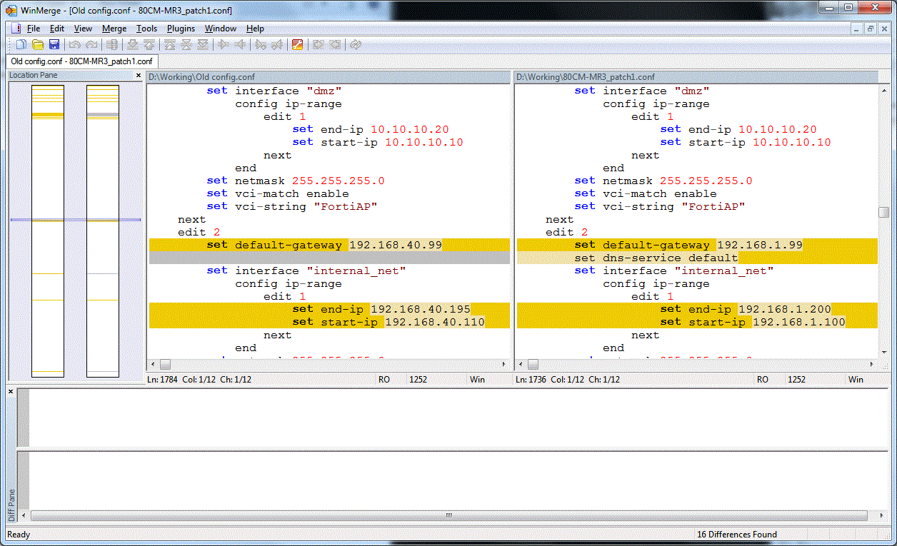

Not at work to confirm this but I thought the direct recommended path to 4.3.14 is >=4.3.11. Regarding your issue, I am guessing you may have a label(s) with an invalid char code and/or space char. I make it a habit of performing " debug config-error-log read" after each firmware upgrade to see if there are any errors or changes to the config. As well, I may go as far as putting the " before" and " after" configs through a text comparison tool.
