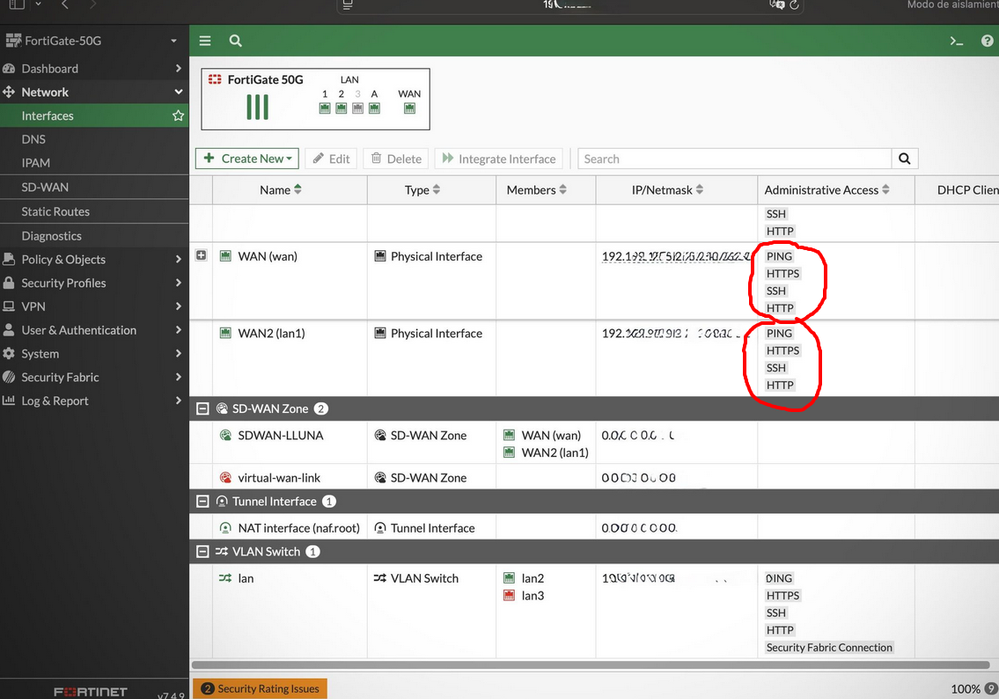

We have a FortiGate 50G installed at home. The device has been set by the company who sold it to us. The FortiGate is used over 2 routers from 2 different providers. We have asked the company to close all the ports as the use of internet here is domestic. When using nmap in order to check possible open ports, the results are:
113/tcp closed ident
2000/tcp open cisco-sccp
5060/tcp open sip
I have used the WAN IP of the Forti as target. Maybe I am doing it wrongly... Here there is the Firewall Policy:
The company told us that the ports are closed but here at home we are a little bit worried. Please, could you confirm that the policies are correct in order to close all the ports? If positive, how is it possible that nmap shows open ports (I have done the process 4 or 5 times)?
We are not professional here and our goal is to be completely protected only.
Thank you very much.

Hi FortiSpain
Sorry for the typo error, I also laughed a lot but it was a mistake and without any bad intention.
Regarding WAN interface, you have multiple services enabled on both WAN ports.
You just need to edit each WAN interface and disable all the services (ping, http, https and ssh).
"I use occasionally a phone plugged to the router"
That explains why SIP and SCCP are listening.
If you want to protect them with the FortiGate you will need to change your design to bring your VoIP behind the firewall instead of leaving it at front-end router level.
Meanwhile you should keep everything patched (router, phone, FGT) to avoid known vulnerabilities, and you may also work with a pentester to check if there are some exploitable breaches.
