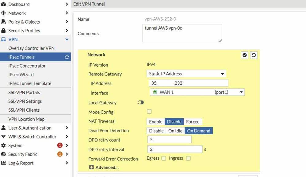

For a client, I am trying to setup a vpn site-to-site from a local Fortigate 200F, firmware 7.2.3, to the AWS site-to-site connectors.
I succeded to make it so I could ping from AWS to a local machine, but ping from a local machine to a AWS machine would not work.
How I did it and config
I went in the docs of AWS and Fortinet, followed them, then downloaded the IKDv2 configuration file, followed the instructions, and it was pretty smooth for those parts.*
Fortigate Network IPSEC tunnels section here:

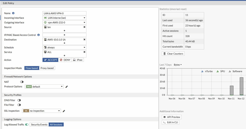

My Firewall policies are there:
And If I DENY my AWS VPN to the local LAN, the pings from AWS to local LAN stops, so this is proof that that direction goes by the Firewall.
If I reverse that by putting "AWSVPN to LAN" to ACCEPT, and "LAN to ASWS VPN" to DENY, there is no difference to my problem obliviously.

I tested the flow filter with a ping, and if I analyse this correctly, everything seems fine on the Fortigate side. Would you concur?
diag debug flow filter addr 10.0.1.77 [AWSMachineIP]
diag debug flow filter proto 1
diag debug enable
diag debug flow trace start 20
id=65308 trace_id=102 func=print_pkt_detail line=5892 msg="vd-root:0 received a packet(proto=1, 192.[localMachineIP]:1->10.[AWSMachineIP]:2048) tun_id=0.0.0.0 from lan. type=8, c
ode=0, id=1, seq=849."
id=65308 trace_id=102 func=init_ip_session_common line=6073 msg="allocate a new session-00078a72, tun_id=0.0.0.0"
id=65308 trace_id=102 func=vf_ip_route_input_common line=2605 msg="find a route: flag=04000000 gw-35.[AWSUpTunnelOutsideIPAddress] via vpn-AWS-232-0"
id=65308 trace_id=102 func=fw_forward_handler line=918 msg="Allowed by Policy-11:"
id=65308 trace_id=102 func=ipsecdev_hard_start_xmit line=669 msg="enter IPSec interface vpn-AWS-232-0, tun_id=0.0.0.0"
id=65308 trace_id=102 func=_do_ipsecdev_hard_start_xmit line=229 msg="output to IPSec tunnel vpn-AWS-232-0 vrf 0"
id=65308 trace_id=102 func=esp_output4 line=893 msg="IPsec encrypt/auth"
id=65308 trace_id=102 func=ipsec_output_finish line=629 msg="send to 64.[IPSrouter] via intf-port1" (port1 is the WAN port, so that's fine)
id=65308 trace_id=103 func=print_pkt_detail line=5892 msg="vd-root:0 received a packet(proto=1, 192.[localMachineIP]:1->10.[AWSMachineIP]:2048) tun_id=0.0.0.0 from lan. type=8, code=0
, id=1, seq=850."
Sorry for the delayed response, yes it looks like you are sending the icmp out the tunnel "enter IPSec interface vpn-AWS-232-0". Ping must be getting lost in the cloud....
If you were to get a response, you would see a new trace come in from AWS tunnel to your LAN, but that does not appear here.
