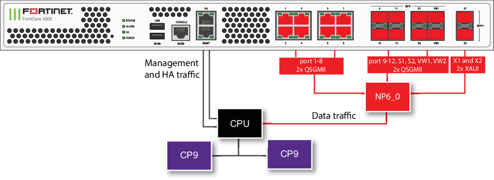

As traffic always passes the NP6 I am asking myself whether there is a kind of limitation regarding UDP traffic?
