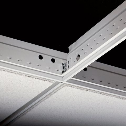

We bought a whole bunch of FAP-421E-A and the ceiling mounting kit does not work.
The t-rail/grid does not look like the standard t-rail and looks like this
Do you know what mounting kit might work?
Jimmy
I know that with the -E (European) model the T-rail clamps do work.
One customer indeed used strong magnets to fix the APs to metal ceiling tiles. Doublesided glue tape didn't last long as the temperature at that height was too high. And it works. Go figure.
here is a picture
