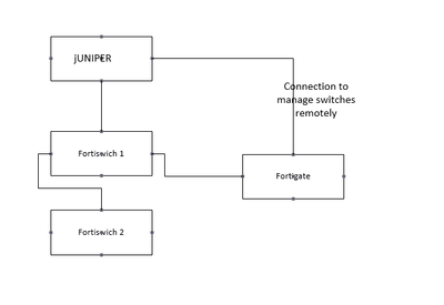

I am hoping i can get some feedback regarding a project that i am currently working on,
In our data center, we are replacing the switches with a managed fortiswiches 2048s. The firewall is a 3rd party appliance and will not be replaced at this moment.
Proposed topology
I would like to manage the switches via the firewall as the controller. is this even possible? Is this a best practice? are there any potential issue with routing/config that i should be aware of ?

If you want to manage the fortiswitch via fortigate you can use this document :https://docs.fortinet.com/document/fortiswitch/7.4.4/fortilink-guide/173260/configuring-fortilink and it is the best practice as well for fortiswitches but if the firewall is not fortigate then I don't think you can manage it via a non-Fortinet vendor
Thank you
What @amrit is really telling you is, you need a FGT as a switch controller as this software is not embedded in 3rd party firewalls of any other vendor, AND yes, the way you have depicted a FortiLink connection to your switches from your FGT (be it local or remote) will allow you to manage the FortiSwitches.
You will have to find out if/how a FortiLink connection is made over a routed connection, if this is really the case in your setup.
Best practice? Nope, but why not. If your FGT is remote, there might be a way.
