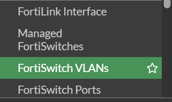

Vlans will be created under "Managed Fortiswitch"/ "Fortiswitch vlan"

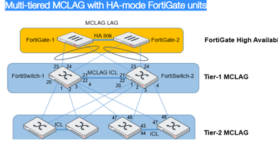

What if I have more than 2 switches , for example I have 7 switches . How can I do that ?
Dear @nrahman
Yes with switches more than two switches, we can have first two core switches directly plugged into the FSW . Configure stacking b/w them (mclag-icl) and connect end switches on the core .
Example architecture :
All these switches will act managed with FGT and configuration will be in Fortigate for all switches.
