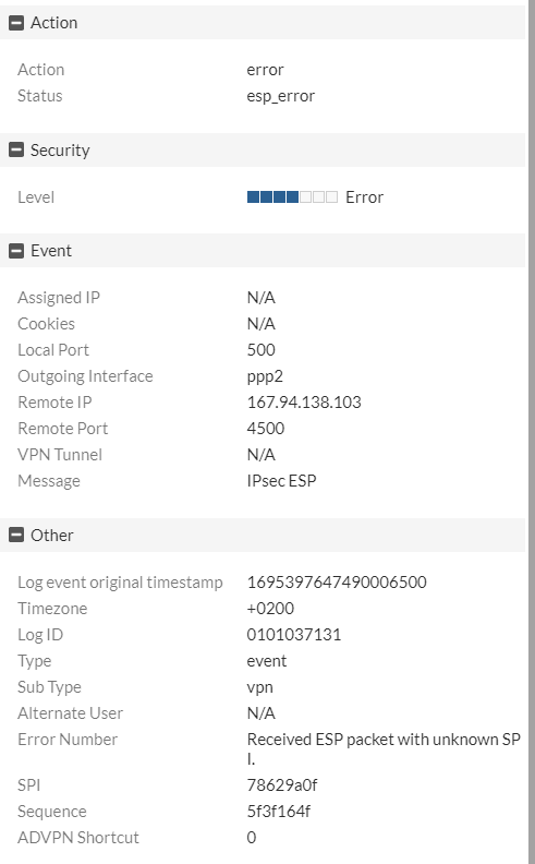

Hi Abdel, thanks for the reply but what you tell me I think is more of a workaround because if I have a local-in-policy that blocks IPSEC traffic, why is the log created in the VPN events section?
If traffic is blocked on the WAN interface it must not be processed by the CPU. As you can see it is as if the package has been processed. It should be discarded directly.

HI @FortiMax_it
This seems to be an expected behavior because this is not a proposal received from remote peer but an ESP packet with incorrect SPI... This packet is being dropped before local-in-policy by the kernel and iked logs it..

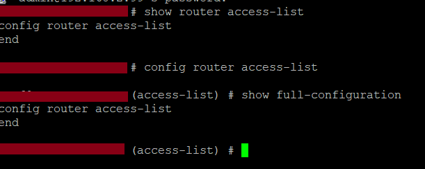

Is you FortiGate support acl? check with the command show router access-list

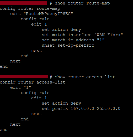

Hi,
does it support ACLs, yes.
I tried to create it, I've almost never used them, I hope I did it right (I'm not sure whether I should put deny or permit in the access list as the route map is already in deny) :D
I'll keep you updated
