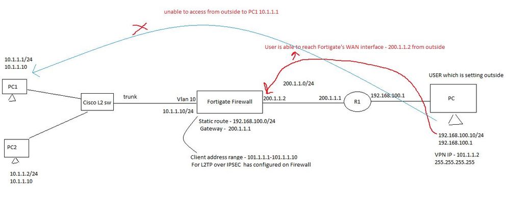

Dear HBAC,
Please have a look diagram.
Reachability -

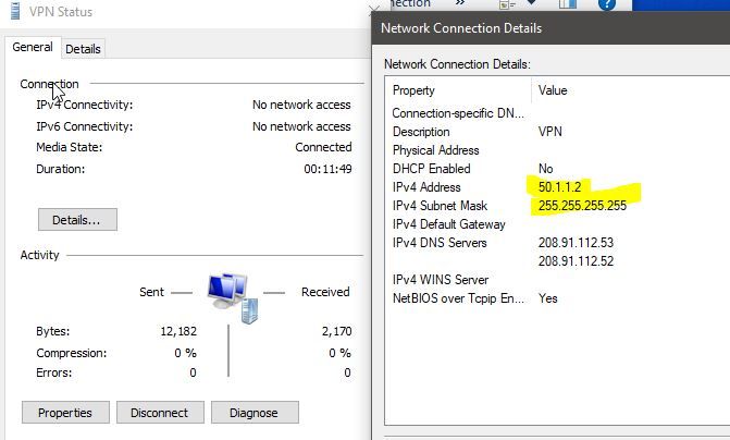

1. User which is setting outside is able to reach Fortigate's WAN interface Port1 200.1.1.2.
2. Able to connect VPN and getting IP address(101.1.1.2) from the range 101.1.1.1-101.1.1.1.
3. When I try to ping from outside to LAN PC1 or PC2, there is no connectivity. getting destination host unreachable from 100.1.1.1 which is the R1 router. you may assume it ISP.

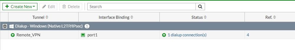

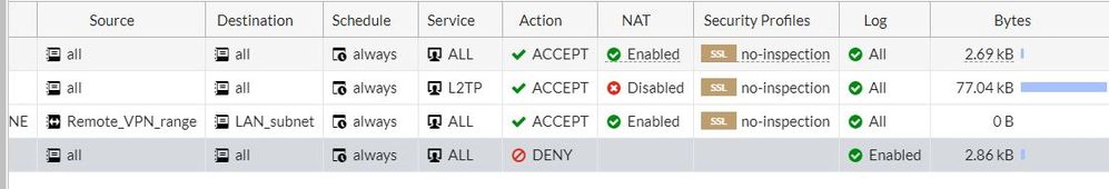

4. I can see that tunnel is up and L2TP policy getting traffic. one more policy is there which is created by IPsec wizard. that policy is not getting any request. source and destination is all.
the question where problem is.

First, you need to check the routing table of the outside PC and make sure it has a route to PC1 and PC2 via the tunnel by running "route print".
It the routes are there, you can run debug flow on the FortiGate and try to ping PC1 and PC2 to see if traffic is being dropped.

Have you configured proper firewall policies from Ipsec interface to destination interface.

FGT_NEXT_Firewall # get vpn ipsec tunnel summary
'Remote_VPN_0' 192.168.100.10:0 selectors(total,up): 1/1 rx(pkt,err): 97/0 tx(pkt,err): 54/0

FGT_NEXT_Firewall #show firewall policy
set name "vpn_Remote_VPN_l2tp"
set uuid 6437e92a-cced-51ee-25d6-9757570e6f5f
set srcintf "Remote_VPN"
set dstintf "port1"
set srcaddr "all"
set dstaddr "all"
set service "L2TP"
set logtraffic all
set comments "VPN: Remote_VPN (Created by VPN wizard)"
edit 3
set name "vpn_Remote_VPN_remote_0"
set uuid 6473a3b6-cced-51ee-4d03-70cb8b2c12e8
set dstintf "LAN_ZONE"
set srcaddr "Remote_VPN_range"
set dstaddr "LAN_subnet"
set service "ALL"
set logtraffic all
set nat enable
set dstintf "port1"
set srcaddr "all"
set dstaddr "all"
set service "L2TP"
set logtraffic all
edit 3
set service "ALL"
set logtraffic all
set nat enable
Note - If you look at the status of VPN, is showing status - status: established 184-184s ago = 90ms
Dear All,
Anyone can update based on above log.
Why I am not able to connect internal networks.
