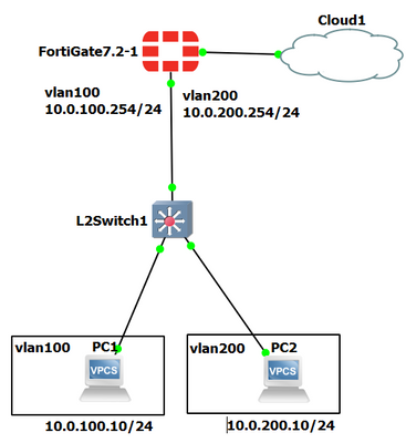

Before implementing the following configuration in production I'm testing it out in GNS3 and I'm facing issues with Inter-VLAN routing. I have configured FortiGate to act as router-on-a-stick.
Please, find the attached images for the reference. I believe I'm not missing anything here. Any suggestions would be helpful.
Network Diagram:

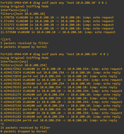

Sniffer Output:

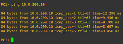

Please find my updated screenshots:
PC1 to PC2:
PC2 to PC1:

thats understood....But i am checking with you that If you upgrade the working FortiGate following the upgrade paths, are you seeing same behavior? Also, if issue persist, could you fetch the debug flow commands posted in my initial response, I am eager to look what policy id is it matching among other info as well.

Is there any vpn configuration on the non working FortiGate? From earlier flows, I notice tun_id=0.0.0.0 info in the lines.
