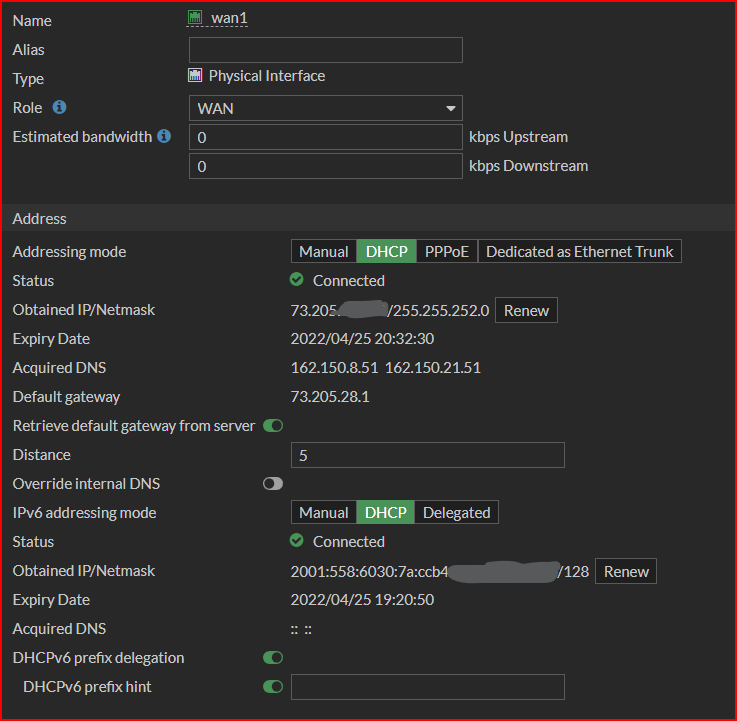

IPv6 on FG-80F 7.2.0
Can someone please help me get IPv6 configured?
I'm on Xfinity and previously had OpenWRT configured with ::/60 prefix but having difficult time with 80F running 7.2.0 getting IPv6 address
No matter what I do, the GUI does not record DHCPv6 prefix hint.
What am I missing?
config system interface
    edit "wan1"
        set vdom "root"
        set mode dhcp
        set allowaccess https
        set ident-accept enable
        set type physical
        set role wan
        set snmp-index 1
        config ipv6
            set ip6-mode dhcp
            set dhcp6-prefix-delegation enable
            set ip6-dns-server-override disable
            config dhcp6-iapd-list
                edit 5
                    set prefix-hint ::/56
        set dns-server-override disable
(ipv6) # get
ip6-mode            : dhcp
nd-mode             : basic
ip6-address         : 2001:558:6030:7a:ccb4:xxxx:xxxx:xxxx/128
ip6-allowaccess     :
icmp6-send-redirect : enable
ra-send-mtu         : enable
ip6-reachable-time  : 0
ip6-retrans-time    : 0
ip6-hop-limit       : 0
dhcp6-prefix-delegation: enable
delegated-prefix iaid 5     : 2601:586:c400:5240::/60
preferred-life-time         : 5850
valid-life-time     : 5850
delegated-DNS1      : ::
delegated-DNS2      : ::
delegated-domain          :
cli-conn6-status    : 2
vrrp-virtual-mac6   : disable
vrip6_link_local    : ::
ip6-dns-server-override: disable
Acquired DNS1       : ::
Acquired DNS2       : ::
dhcp6-iapd-list:
    == [ 5 ]
    iaid:     5       prefix-hint: ::/56           prefix-hint-plt: 604800           prefix-hint-vlt: 2592000

I have completed the config, just needed to read up
sdresen
Do you mind sharing your working config?  Wrestling with the same issue and haven't figured out a working config yet.  Would appreciate it, thanks.
