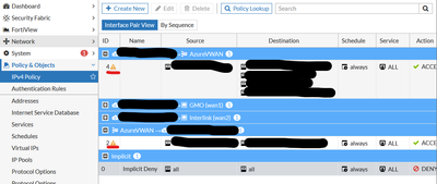

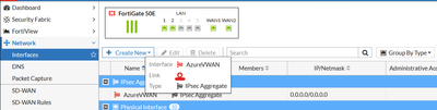

I'm currently trying to setup IPsec aggregate with 2 WAN ISP links.
After all the configuration(IPsec phase1-interface, phase2-interface, ipv4 policy, routes),
both IPsec tunnels comes up and actually it work perfectly as expected,
except the warning messages in GUI.
Do someone experienced same issues or any tips to erase these warning messages ?
Model: Fortigate-50E
FortiOS: v6.2.9 build1234 (GA) [* tried newest v6.2.10 build1263 (GA), but same]
Issues: Warning message remains in GUI

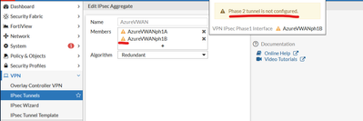

1. IPsec tunnels both up.
2. IPsec aggregate members are both show as "Phase2 tunnel is not configured". (Strange)
3. IPsec aggregate interface shows LinkDown, but actually working. (Strange)
4. As a result interface LinkDown, related IPv4 Policy show warning, but actually working. (Strange)

Hello,
Which browser are you using? Is this behavior seen on different browsers?
Best regards,
Jin
Hello Jin,
I've checked with Firefox and Google chrome, but no luck.
Thanks,
Tomioka
Hi Tomioka,
Thanks to check this from different browsers. The issue may be cosmetic and may be reported to support after gaining required contracts.
Best regards,
Jin
