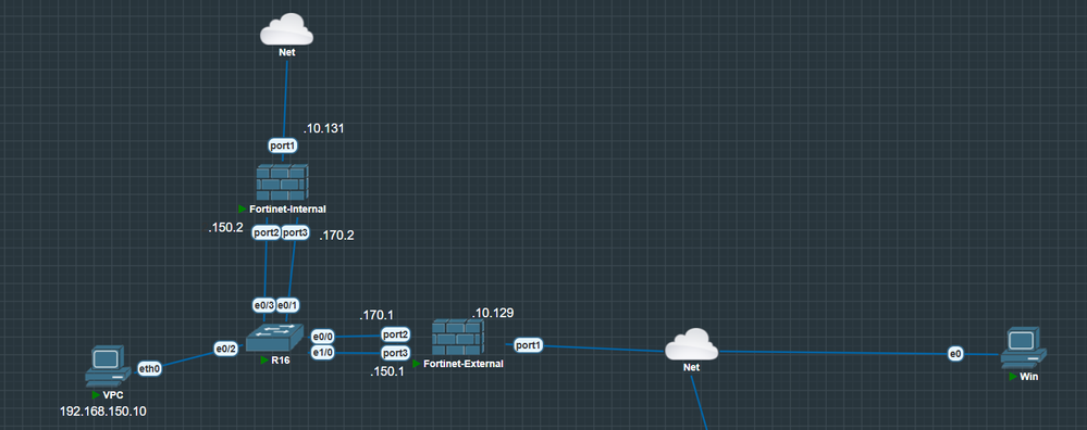

Hello Fortinet Community,
I am working on a lab / design scenario and would like to ask for guidance on whether this setup is technically supported or if there is a recommended workaround.
A FortiGate External is deployed at the edge (Internet-facing)
A FortiGate Internal is deployed behind it
The Internal FortiGate is intended to terminate IPsec Remote Access VPN (FortiClient)
The External FortiGate acts only as a border firewall (NAT / routing)
So i wanna ask you whether my topology working normally, if yes, can you guide me how to deploy, thanks very much

Hello
Sure it is technically possible. If you use UDP (default), on ext-fw just forward the incoming UDP-500 and UDP-4500 from WAN to the int-fw (using DNAT or just routing depending on the case), and allow outgoing UDP-500 and UDP-4500 from int-fw to WAN (using SNAT or just routing depending on the case)
But I wonder if it is a more correct design to setup the internal firewall as VPN server or to setup the external one. I guess the external one.
