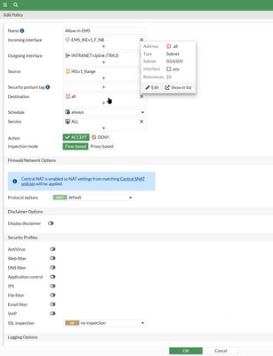

Hello,
I created the following rule to allow an IPSec client network aka EMS_IKEv1_F_NB [198.18.27.0/24] to access Intranet aka TRK3 [192.168.0.0/16]. Nevertheless the clients is blocked by the implicit deny rule.
When I try to check the policy using the Policy Match Tool while the client is connected it returns "No route exists from source address 198.18.27.2".
But get router info routing-table details shows
S 198.18.27.2/32 [15/0] via EMS_IKEv1_F_NB tunnel 198.18.27.2, [1/0]
while the client is connected.
FGRO01 (vdom) # edit root
current vf=root:0
CFGRO01 (root) # config firewall policy
CFGRO01 (policy) # edit "32"
CFGRO01 (32) # show
edit 32
set name "Allow-in-EMS"
set uuid d90bd78a-fe42-51ee-5614-00952a1efac4
set srcintf "EMS_IKEv1_F_NB"
set dstintf "TRK3"
set srcaddr "IKEv1_Range"
set dstaddr "all"
set service "ALL"
set logtraffic all
best regards
Martin

Hello @AEK
thank You for Your quick reply.
The orange line show traffic to the intranet DNS server 192.168.3.41. But it is blocked by implicit deny. Port 10 is the WAN port.
Here is the output of:

Hello Martin,
The DNS traffic from 198.18.27.2:56766->192.168.3.41:53 is allowed by firewall policy:
30 and in the deugs we see reply packet from the DNS server too.
received a packet(proto=17, 192.168.3.41:53->198.18.27.2:56766) tun_id=0.0.0.0 from TRK3. "
id=65308 trace_id=52 func=resolve_ip_tuple_fast line=5924 msg="Find an existing session, id-0054cf5e, reply direction"
id=65308 trace_id=52 func=vf_ip_route_input_common line=2612 msg="find a route: flag=04000000 gw-198.18.27.2 via EMS_IKEv1_F_NB"
The deny traffic is for traffic from 198.18.27.2:57807->456.456.456.456:80.

I think the return packet is being dropped. See "act-drop".
id=65308 trace_id=52 func=iprope_policy_group_check line=4884 msg="after check: ret-no-match, act-drop, flag-00000000, flag2-00000000"
Although it found an existing session and it said "Find an existing session, id-0054cf5e, reply direction".
Can you post a screenshot of the related policy (id 30)?

Do you have any VIP or IP pool in the same subnet as the IPsec client?
