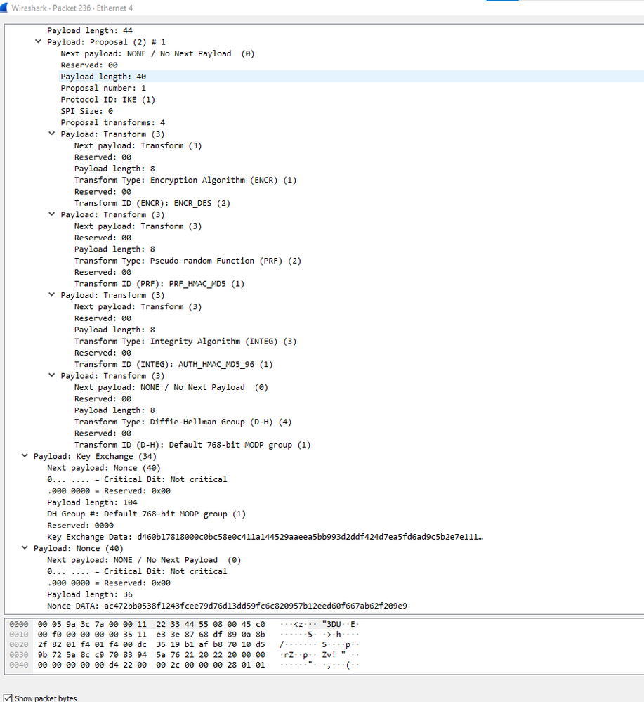

I am new to this forum, I am trying to setup VPN connection between Nokia 7750 SR router to FortiClient VPN,
below are the config settings.
Please note:- This issue happen only Option DHCP is selected, the VPN tunnel comes up correctly when manual IP is selected.

7750 Router is config as IKEv2 with all the config matching to FortiClient VPN. For DHCP option router is dumping below messages.
failed because ipsec-gw has local-address-assignment configuration but IKE_AUTH did not contain a config payload."
Please find the attached screen shot of all the four packets attached,
It will be really help if you some one can find the root cause.
