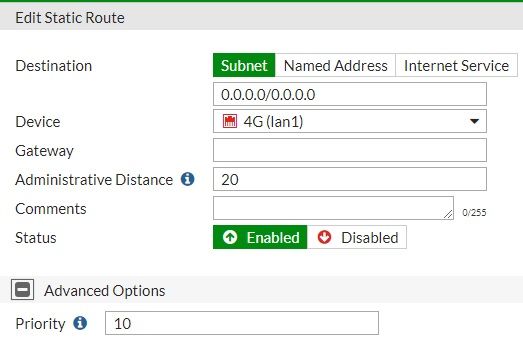

In addition to that when 4G cable is unplugged and NBN is active as soon as 4G is plugged back connection switches to 4G.
I enabled snat-route change but Fotigate still switches back to 4G.
Attached screenshots of the configured static routes.

Interesting. Can you show the output of the routing table when the 4G modem is plugged in?
Resolved by increasing Distance value on the interface 4G modem is connected to.
