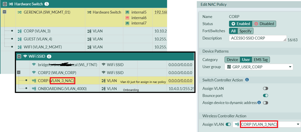

From Fortiswitch, Nac policy is working, but from SSID perspective, you needed to recreate the same Vlan IDs to NAC policy work? Or are you just asking about how to have it working? I Have tried to test NAc policy from SSID in tunnel mode, and it works fine, but when try to migrate that to Bridge mode, does not work. I think we have the same doubt.
To use the nac policy in bridge mode, it is sufficient to create an ssid and enter the vlan id information of the network that you will bridge from any subnet definition.
After your last message, I have tested recreating VLAN ID under SSID interface, and tested NAC policy with SSID in bridge mode again, and it worked fine for me (7.2.11). Before, with only VLAN ID on trunk interface only (under hardware switch), it was not available to use in NAC Policy. Now I have the same VLAN ID created under Trunk interface, and SSID interface.
In my specific case, trunk interface is not a Fortilink interface. I don´t have Fortiswitch between Fortigate and FortiAP.
