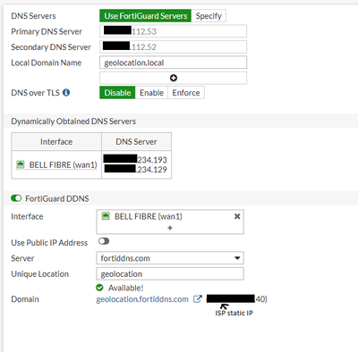

We switched ISP a couple months ago for a Bell Gigabit Fibe Ethernet. They gave us a HomeHub 2000 that I had to put in bridge mode to stop it from acting as NAT router (first problem).
I then setup the WAN1 connection using the Bell credentials in PPOE and I could not get any signal.
I called Fortigate support and we setup a DNS using fortiguard effectively creating a domain name linked to our static IP.
Is this correct ?
I found two similar threads but neither mention if they have static IP. Ultimately I would like to remove the fortiguard DNS server causing latency.

There is no need to configure fortigaurd DDNS if you have static IP.
Thank you for your input @rosatechnocrat, I did some digging up and found that Bell fibre uses VLAN 35. I will try to remove the DNS server and redo the WAN interface.

@Toshi_Esumi , thank you for sharing your setup. Fortunately, the ONT is in the same room right beside the Fortigate. Did you have to tag your packets ?
Created on 05-03-2023 08:04 AM Edited on 05-03-2023 08:09 AM
Yes. Lumen(formerly CenturyLink) uses VLAN 201. So I've set the valn subinterface with vlanid 201 on wan interface of my 40F.
<edit>Make sure you change the default "DHCP" setting on your wan1 interface to like "static" to avoid accidents or for security.</edit>
