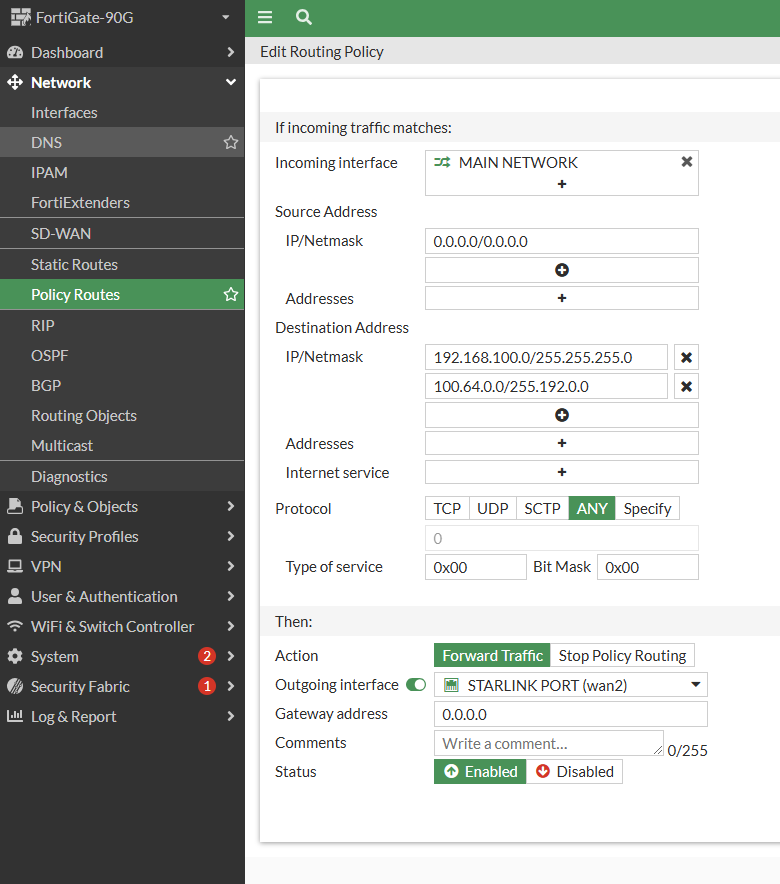

In the policy route you have the option to leave only the Outgoing interface. Remove the Gateway IP entry.
Does that still fail when the WAN IP changes?
No way,
Starlink antenna with this IP because it find satellite:
And this is the Policy route:
App not work, from ipad I can't reach the Antenna
When antenna(dish) reaches the Starlink network the WAN apparently gets an IP from 100.64.0.0/10
https://www.starlink.com/support/article/1192f3ef-2a17-31d9-261a-a59d215629f4
You will need to also have a static route toward 100.64.0.0/10 through WAN2.
That policy route will not match anymore since you have put as destination address only the 192.168.100.0/24. You need to also add 100.64.0.0/10 as destination.
If only the outgoing interface is specified in the Policy route, FortiGate will look up the routing table(FIB) to find the gateway for 100.64.0.0/10.
Since network 100.64.0.0/10 is not learned dynamically, you will need to add a static route in order to be able to reach the antenna once it connects to the starlink network.
Also check in the traffic logs what traffic patterns does the Starlink App generate. This way you can properly match that traffic in the policy route.
