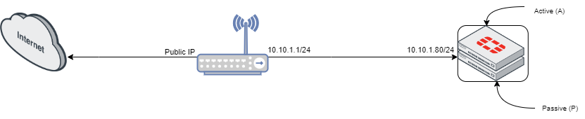

I am currently setting up a test infrastructure to update all our fortigate to forti os 7.0.x.
For now all the fortigates are in version 6.4.12
I declare the IP 10.10.1.80 as my DMZ (only one IP can be set as DMZ) and until two days ago all the connection was sent to the FortiGate and all was working so for example when I wanted to connect to the SSL VPN I was using the public IP of the router and it was working fine, I could also ping and connect to a Forticlient EMS that I had set up.
But to test the failover I restarted the active FortiGate, at this moment I loose my VPN connection, and I also loose the connection on the local address.
From this moment I never got access again to the fortigate outside of my network again.

To make sure the problem was not from my router, I set another device as DMZ and I could access it from internet. So the problem is probably on the fortigate.

how is your DMZ set up on the router? Is it just pointing to an IP address? Could be when you switched HA the router didn't get the GARP. Try rebooting your router?
Can you change your router into bridged mode? This way the FortiGate will receive the public IP directly and will make your life easier without doing double NAT etc.
