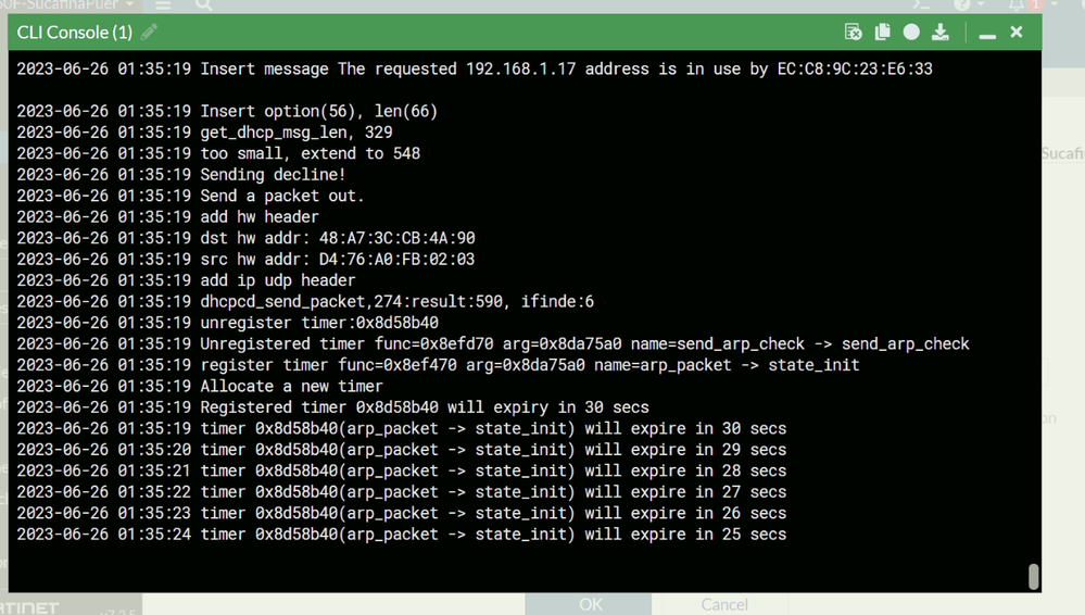

Please take the below debug on Fortigate :
diag debug reset
diag debug console timestamp enable
diag debug application dhcpc -1
diag debug enable
Change the Interface to manual and save it, revert it to DHCP let the debug run for 30 sec, and share the output.

Hi Manosh,
You mean this :

I ran into a similar situation the other day with a new T-Mobile backup connection I plugged into my FortiGate. I connected my laptop (wired) and it worked fine. When I plugged that into my firewall, it would not get an IP via DHCP. I power cycled their antenna/modem device and then was give an IP address to my firewall. So thinking their antenna "married" itself to the first MAC address that connect to it and did not like swapping to another without a antenna/modem reboot with the new device (firewall) already connected. Worth a try.
Created on 06-21-2023 02:05 PM Edited on 06-21-2023 02:16 PM
For T-Mo's device, or any other 4G/5G termination devices like Cradlepoints, it probably has "IPPassthrough" setting by default, which relays IP from the carrier's GW to the device behind the termination device. In those cases, DHCP server is on the carrier side and it doesn't know when something is swapped on the LAN side of the termination device.
So you need to take the 4G/5G connection down once to pull the IP again to a swapped LAN device.
Toshi
