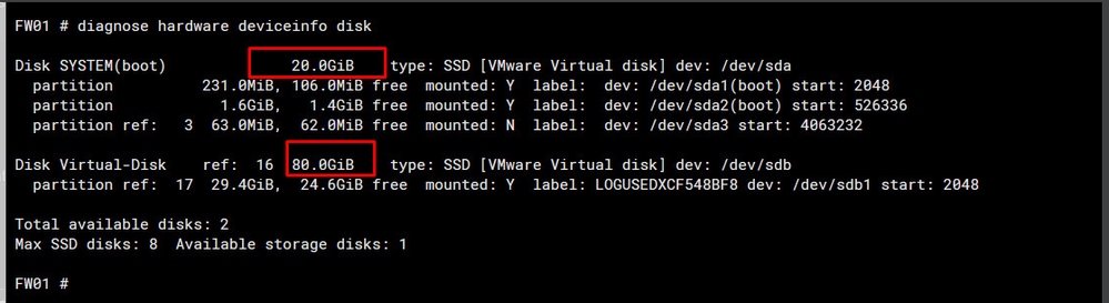

I want to check the current sttatic of disk-usage in fortigate VM.
My Fortigate Vm running on VMWare have 2 disks: Disk SYSTEM (20.0GiB) and Disk Virtual-Disk(80.0GiB)
I tried the deviceinfo command above, but the static is confuse. How can I check the total disk-usage?

@Donglv9
I think we have the solution here.
You have a 80GB HDD but you are using only:
set size 30107 (29.4GB)
In order for you to use the whole HDD you have to change
config system storage
edit "Virtual-Disk"
set size 81920
After this change you will use all 80 GB and see correct values.

@xshkurti
It doesn't show the used percentage of the 80Gb disk.
@Donglv9
edit "Virtual-Disk"
set size 81920
If you have found a solution, please like and accept it to make it easily accessible for others.
Regards!
@xshkurti
@xshkurti
I see the problem!
But can I set the size 30Gb to 80Gb on Fortigate, can you show me?
There is no command to set the size to 81920 as your comment above.
