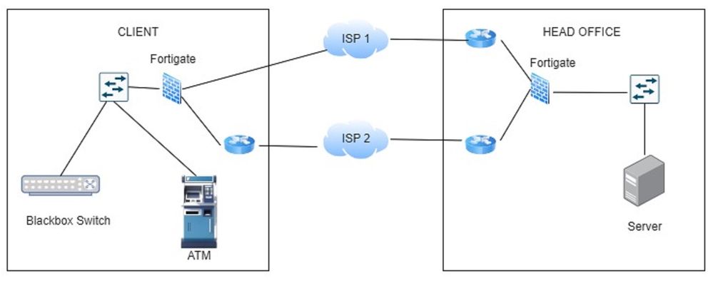

Hi All,
We are having issues in our MPLS - IPsec VPN Tunnel, please see attached network diagram for reference.
Whenever we up the tunnel in ISP1, we have no problem.
1. We can access the ATM and Blackbox Switch from the server and vice versa. We also have a test laptop in the client side which I forgot to in include in the diagram.
2. We can traceroute the traffic and see that it is passing through the expected path, which shows the IP address from both sides in ISP1.
3. Even on Fortigate logs, we can see that traffic is using the right policy and static route.
The problem start when we swing to ISP2, for HA testing.
1. We can still access the test laptop from the server and vice versa. We use the test laptop first before we proceed with adding the ATM and Blackbox, which is what we did in the ISP1.
2. When we traceroute the traffic, we can still see that it is passing through the router in the ISP1 of the client side.
3. The client also tried to traceroute from their end, and it can reach the server, but we cannot see the IP address of our Head Office router and Fortigate firewall when they send the screenshot of the traceroute result.
4. We tried to disable the tunnel of ISP1, disable the static route from both firewall and even the policy, and still when we do a traceroute, we can still see that it is passing through the ISP1 of the client router. The client tried again to traceroute, but still we cannot see our IP addresses.
5. When we check the Forward Traffic in the Fortigate, it shows that it is passing through the right policy, which is using the ISP2 tunnel.
6. When I checked the "diag debug application ike -1" command and enabled it, it is still passing through the tunnel in ISP1 with error "error 101:Network is unreachable" and "could not send IKE Packet(ident_i1send)". Maybe because the tunnel in ISP1 is down.
Does anyone knows why is this happening?
Thank you so much who can help us.

Do you see the tunnel over ISP2 up at both side of the FGTs? You should run the IKE debug by specifying the ISP2 side of the public IP on the client side when you run it on the head office FGT.
"diag vpn ike log-filter dst-addr4 [peer_public_ip]"
before the ike app debug command.
You mentioned "for HA testing" and "use the test laptop first before we proceed with adding the ATM and Blackbox". How exactly are you doing this test? If they're in the same sbunet, you generally can test all at once only, like by taking the tunnel over ISP1 down, so that both ends can failover to the ISP2 tunnel at that same time, which is necessary to avoid asymmetric routing per direction.
Toshi

Adding to @Toshi_Esumi's reply. I see a router in front of the FGT on ISP2 on the client side but not on the ISP1. Is this the real topology or you just forgot to add it?
Assuming you have the same settings on both sides for ISP1 and ISP2 but a extra router is between FGT1 and FGT2 via ISP2 maybe it is the reason of the issue. This is just a hypothesis. Follow the instruction suggested by @Toshi_Esumi first so we can get a better understanding of what is happening.
