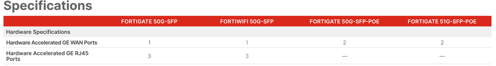

Given your previous explanation, why does Fortinet identify only the PoE version as dual WAN, when other models in the same 50G series can also be configured for dual WAN? In the screenshot I attached you can see they identify some models with one hardware accelerated WAN ports and other models with two. I think they do the same with the 30G and 40F. Any reason for this?
I had a look at the schematic for the 50G-SFP vs the 50G-SFP-POE, it looks like for the POE version the RJ45 WAN port is not in the same physical switch as the rest of the RJ45 ports. I think the only tangible difference to the end user would be that you cannot add all 4 RJ45 ports into a hardware switch, whereas the non-POE would be fine with you doing this.
