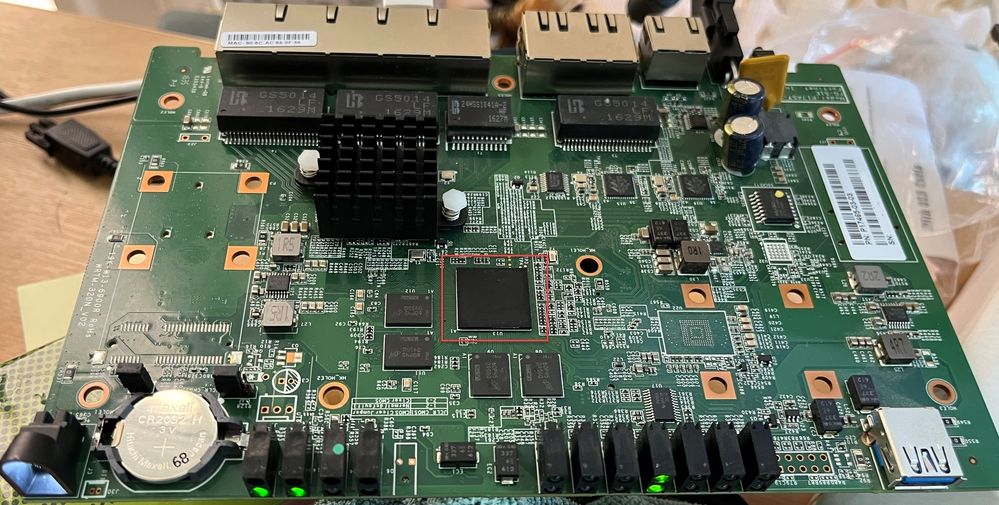

We have seen several of these appear over the past 6 months so I have opened one and had a look at it (I am an electronics engineer and like to fiddle more than I should!).
My dead 50E is now alive and kicking having reheated the main CPU which is a small BGA device under the heatsink. (For history this is a common problem with BGA devices which dont have enough cooling, especially following the introduction of lead free solder 10 years ago. This results in slight expansion of the cpu / board and mild warping and then the previously flat cpu sitting on a bed of solder balls develops a dry joint and thus a bad connection).
I ran ping test from the previously unresponsive LAN side and saw 400 packets with 1 dropped packet and a fully responsive web interface (this was completely dead in this instance previously). I have also updated the firmware and will soak test this now to see how it perfoms over a few days / week.

@Rob_Roche Do you have before and after pics?
Not much difference to be seen, however here is a pic from after it was heated and was running - CPU highlighted. (yes I know it should have a heatsink on it - was testing in the immediate aftermath)
