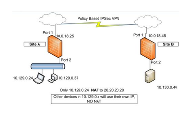

i am trying to setup a VPN Site2Site connection, policy based with source NAT.
Fortigate 40F, v7.2.4
The target network is a customer network and cannot be configured.
I'm basically following the tutorial in this article (Scenario A)
The topology looks like this (where SiteB is Customer), and the NATting should only be done for the 10.129.0.24 IP Address (in my case, cus_local_subnet_1)

Hi Gateberg
Is there a reason you are you using policy-based ipsec? Can you use route-based?
When using route-based you can just create a basic fw policy with SNAT applied for that one device.
Route based is not possible, we cannot make changes on the customer site.
Maybe the issue starts earlier, as i cannot see any traffic on the tunnel:
You may try to use Central NAT for such scenario which will separate NAT from Firewall rules. But this change has to be planned if you are already using NAT in the Firewall rules.
AFAIK route-based vs policy-based is a local construct on the FGT. It's just two different ways of configuring the IPSec tunnel. The remote side does not care what you are using. It's just typically a much easier way to manage and configure the IPSec tunnel on the FGT.
