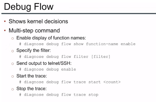

Please make sure all required services like ICMP are present in policy. check the logs for which you are not able to access destination. Run debug flow to troubleshoot issue, it will give you reason for drop. Hop this will help.

You can enable the following debug logs and test again.
diagnose debug disable
diagnose debug reset
diagnose debug cons time enable
diag vpn ssl debug-filter src-addr4 x.x.x.x (Replace x.x.x.x with the IP address of the PC connected to the SSL VPN)
diagnose debug app sslvpn -1
diagnose debug enable
***********reproduce the issue**********

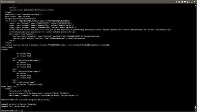

I'm logged on the firewall CLI Console there is no ssh or telnet enable.
When i type : diagnose debug disable
I can't make any diagnostic, because the command are not working :
Someone has an idea ?
