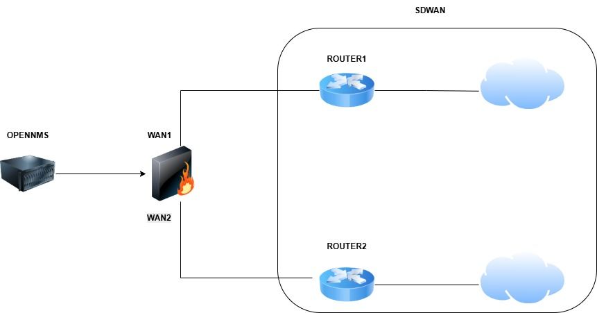

on Fortigate 1100e (7.4.9) we set up an SDWAN like this
We would OpenNMS pinging a public ip (8.8.8.8) through the line of ROUTER1 and another public IP (8.8.4.4) through the line of ROUTER2. So we set up these policy routes:
SOURCE DESTINATION GATEWAY
OPENNMS 8.8.8.8 ROUTER1
OPENNMS 8.8.4.4 ROUTER2
In static routes we have:
0.0.0.0/0 SDWAN
In SDWAN policy we have the default (selected members by source IP)
When both interfaces WAN1 and WAN2 are up all works, but:
when both interface are up, traceroute show that the routes are correct (the ping towards 8.8.8.8 choose WAN1 , while the pings toward 8.8.4.4 choose WAN2)
Any ideas?
Thanks

hi,
do you do NAT on the FGT or on the routers ?
diagnose firewall proute list - shows correctly what you have configured / can you post it ?
Created on 12-05-2025 12:30 AM Edited on 12-05-2025 12:32 AM
NAT is on the FGT

Both policy work when both interface are up, but If we deactivated WAN1, both pings not work

If we disabled one interface of the SDWAN, all others client using SDWAN works, except the ping from OpenNMS.
Maybe the problem is having policy routes AND SDWAN together?

Ok but we have only the implicit SDWAN rule and 2 policy routes
The policy routes seems working when both interface are active, but if we disable WAN1, the policy routes toward "ROUTER2" not working (the policy is matched but we see 0 bytes of response in firewall logs)

Yes, we did it exactly: tried to delete policy routes and set 2 SDWAN Rules like these:
SOURCE: OpenNMS Destination: 8.8.8.8 Criteria: Forced member WAN1
SOURCE: OpenNMS Destination: 8.8.4.4 Criteria: Forced member WAN2
but we still got the same problem ( with set auxiliary session enable and disable)

I found the problem.
I used a wrong NAT on firewall Policy
We need 2 policy:
OpenNMS -> 8.8.8.8 -> NAT WAN1
OpenNMS -> 8.8.4.4 -> NAT WAN2
