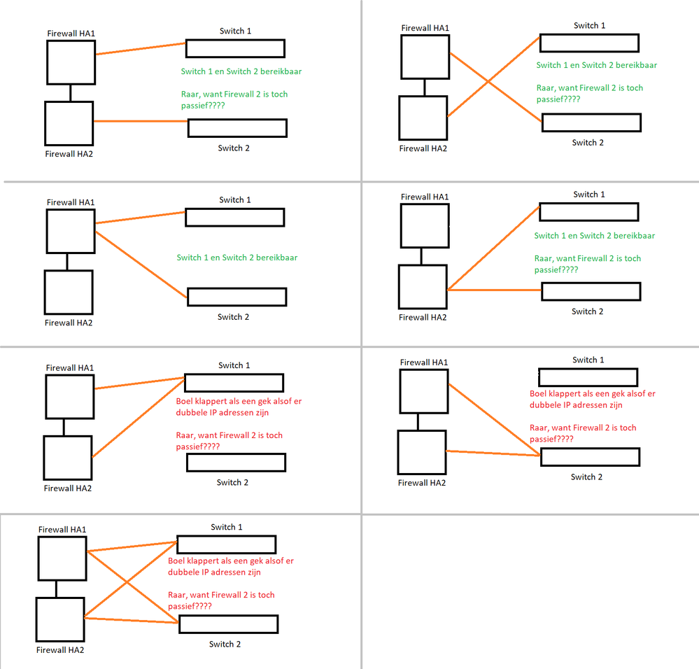

we have recently bought two Fortigate 100f Firewall and set them Active Passive HA mode.
One would expect 1 Firewall to be active and 1 to passive, as the name suggests. But it looks like both are active?
The thing is, if I attach a Layer2 Switch with an IP address to FW1, it works and I can ping it. Just like expected.
If I connect the same Switch to FW2 only, it works and I can ping it. Strange, because FW1 is active?
If I connect the same Switch to FW1 and FW2 (for redundancy) my networks goes down, my laptop hangs and I cannot ping a thing. So looks like a double IP address issue.
So what am i doing wrong? Or do I not get how Active-Passive is suppose to work?

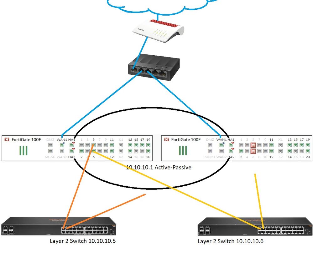

We have FW1 and FW2 connected to eachother with UTP via HA1 and HA2.
We have FW1 and FW2 connected to a simple 5Port Switch for Internet with UTP via WAN1
We have FW1 connected to Switch 1 with UTP via port 5 and to Switch 2 with UTP via port6
As soon as I plug in FW2 to Switch 1 with UTP via port 5 and to Switch 2 with UTP via port6 everything goes down and starts flapping.
And the strange thing is (in my opinion) it doesnt matter to which FW I connect the Switch. They will both be available and connected. But as soon as I connect 1 Switch bot both FW's it's goes wrong
