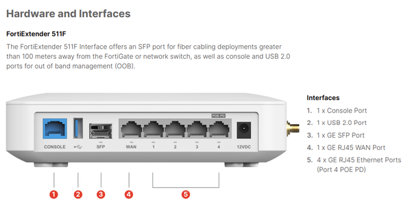

Hello @Beneto ,
yes FortiExtender supports WAN connectivity options with an Ethernet WAN port. So you can deploy it that way.
Check the data sheet for more detailed information:
