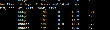

FortiWifi 60C high CPU usage
Anybody experience high cpu influx on the FortiWifi 60C? We have one location that is located next Pizza hut. Everytime they Pizza hut open, it kill off our wifi and driving our Fortiwifi cpu usage bonanza.

Ede, We have the trusted hosted define for our admin. Only two host is allow to connect to this device. The weird part is whenever I browse around the web interface or screen. The CPU usage skyrocket.

If you close all your HTTP* sessions and only have a active SSH session, does the CPU still strugling with high CPU @ the HTTP* threds? Do you use SW-switching between a internal interface and the Wifi? Do clients get deauthenticated, after a short while when they should not be?
Fortigate <3
Phuoc_Ngo
New Contributor
yes, the cpu stil spike even with the active ssh session. I don' t believe we have anything configure for SW-switching between internal and wifi. We didn' t get any logs indicating client get deauthenticated. The symptom we experience is that the Wifi SSID signal got drop off completely from range.
