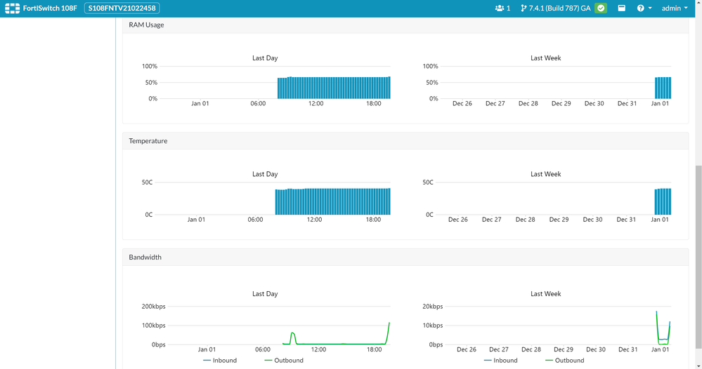

1. There are several events about CPU_SENSOR reached/exceeded the threshold value, is it related to HW issue?
2. In the idle mode, no idea why the memory always over 60% utilization, and the system temp around 39~40 degree C.

I am experiencing the same behaviour. Did you find a solution to this Problem? In my case the Switch is managed by an FG HA Cluster. The switch runs at 9% CPU usage and then every now and then reaches >87% and loses its connection to the management. After a while it comes back online and cpu goes down again.
