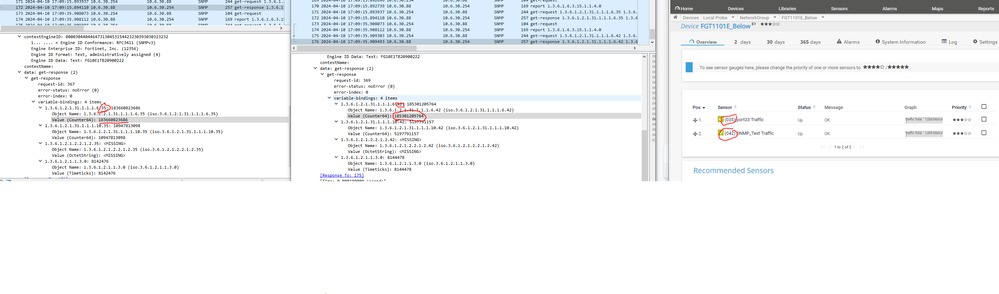

Hi Aguerriero
I have tested your issue in my 2 FGT1101E. However, in my lab, I got the normal result, which was reported from 2 interfaces quite equally. You can check my picture in the attachment.
For your case, can you do this :
Step 1. Clear counters in 2 interfaces and checking by commands:
Diagnose netlink interface list port33 ! (Physical)
diagnose netlink interface list SNMP_Test
!(IPsec VPN)
diagnose netlink interface clear port33
diagnose netlink interface clear SNMP_Test
diagnose netlink interface list port33
step 2. Get snmpwalk or visually them in PRTG/Cacti
Regards
Bill

Hi Aguerriero, We retested your case in Agg interfaces. The result from the IPsec tunnel vs. the Agg interface reported the same result for SNMP.
Do you have any special configuration in Aggregate Interface? What is your SPF type?
Thanks
