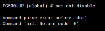

I am trying to find a way to disable daylight saving time on the active timezone on FortiOS 7.2.7.
But apparently the option presented in the following posts is missing!
https://community.fortinet.com/t5/FortiGate/Technical-Tip-How-to-disable-daylight-saving-time-DST-fe...
This command was removed since firmware version 7.2.1. The scope of this command was to correct the time in cases when time zone was missing and wasn't able to determine the DST.
The DST will be handled automatically, shown as "Observing":
Basically if the timezone is identified correctly there is no need to manually change the DST anymore.
@ebilcariHi and thanks for your response. But the issue is that the device has not determined the time offset correctly. DST was removed from my timezone in the late 2022, but the firewall is still considering time offset schedules as planned before the change.
If the DST is wrongly calculated for your timezone please create a ticket with TAC support to get this fixed.

FG500-UP (global) # show system global | grep time
set admintimeout 480
set proxy-auth-timeout 5
set timezone 41
FG500-UP (global) # diagnose sys dayst-info
The current timezone '(GMT+3:30) Tehran' daylight saving time starts at Sun Mar 17 00:00:00 2024, ends at Tue Sep 17 01:00:00 2024
I did observe the same issue in my lab for version 7.2.7 however upon upgrading to 7.4.3 this is the output of dayst-info
<hostname> # dia sys dayst-info
The current timezone '(<+0330>-3:30 Asia/Tehran)' doesn't have daylight saving time.
