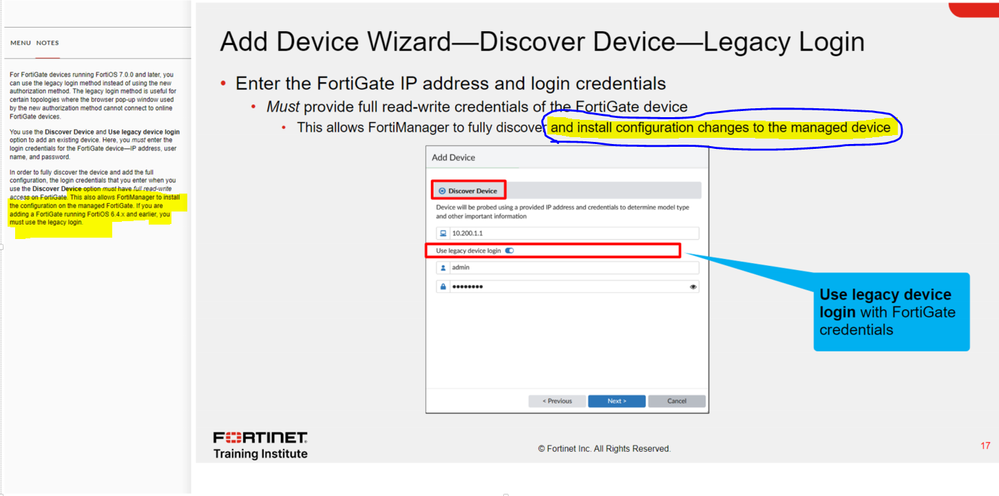

H Suraj,
thanks for the input, please do we have any documentation oder KB regarding your statement? Attached is what I have found from FMG v7.2 Self Paced Training that clear says it is used also for „install configuration“ but which cases?
My input was based on an internal document, let me check if there is a public version of the same and share it.
Hi Suraj,
I have found the info from your statement some slides later as attached here.
Yeah, the credentials are used during the „add process“ and then the Serial Number is used to establish and authenticate the FGFM tunnel.
Tks for the colab!
