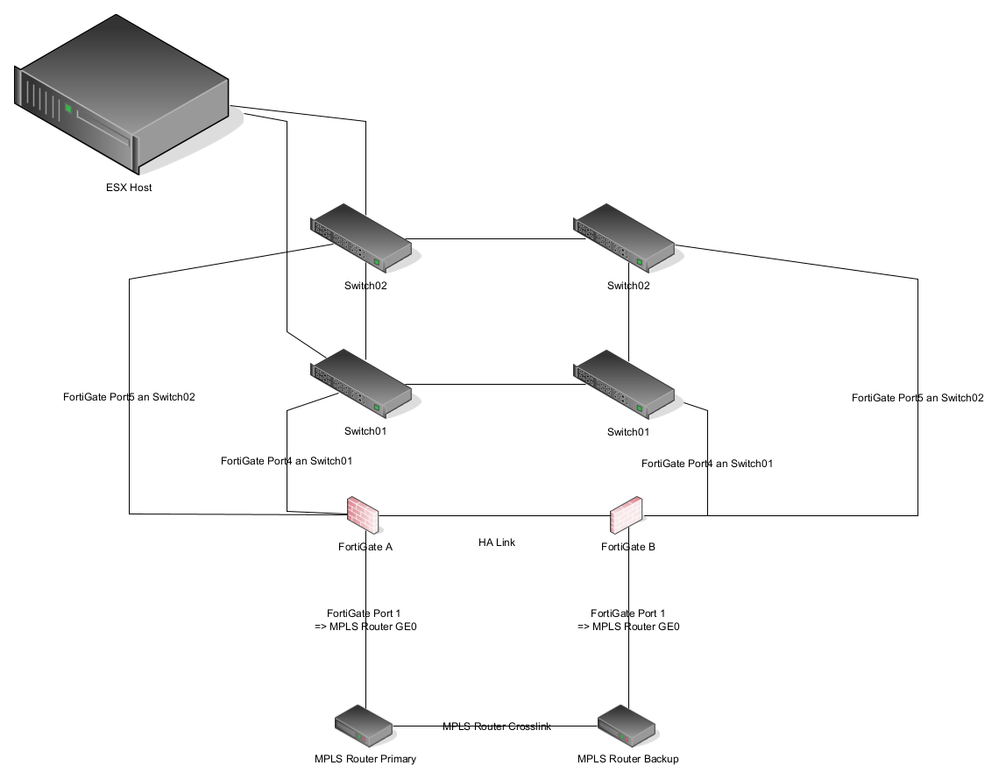

I've made a little drawing that might better show how I envision it and if it can be done that way.

If your switches are independent use hardware switch but a logical switch use redundant or STP will kick in and block one port to prevent loop... How is the ESXi host configured?
Can you name in your drawing how the switches are connected together?
Abdel
the four switches are connected via 10g sfp to each other with stp configuration.
the esx host is normal configured with 4x lan to switch 1 and 4x lan to switch 2.
In this case try redundant interface since STP is running on the switches no matter what port is active traffic should go through...
Abdel
