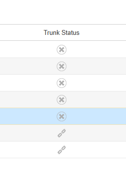

I’m having an issue with a Yeastar S20 IPPBX behind a FortiGate in a double NAT setup, and I’m looking for help.

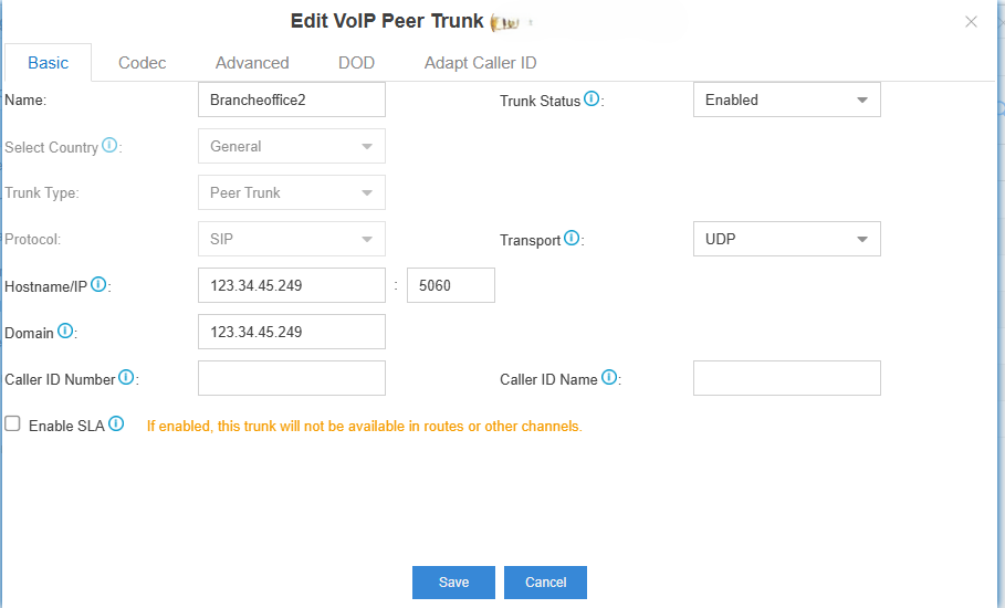

The FortiGate is behind an ISP modem (not in bridge mode). The Yeastar is behind the FortiGate, and SIP trunks connect it to other Yeastar systems on remote sites.
When the Yeastar is connected directly behind the ISP modem (without the FortiGate), the SIP trunks work fine.
Once the Yeastar is placed behind the FortiGate, the trunks no longer establish, even though:

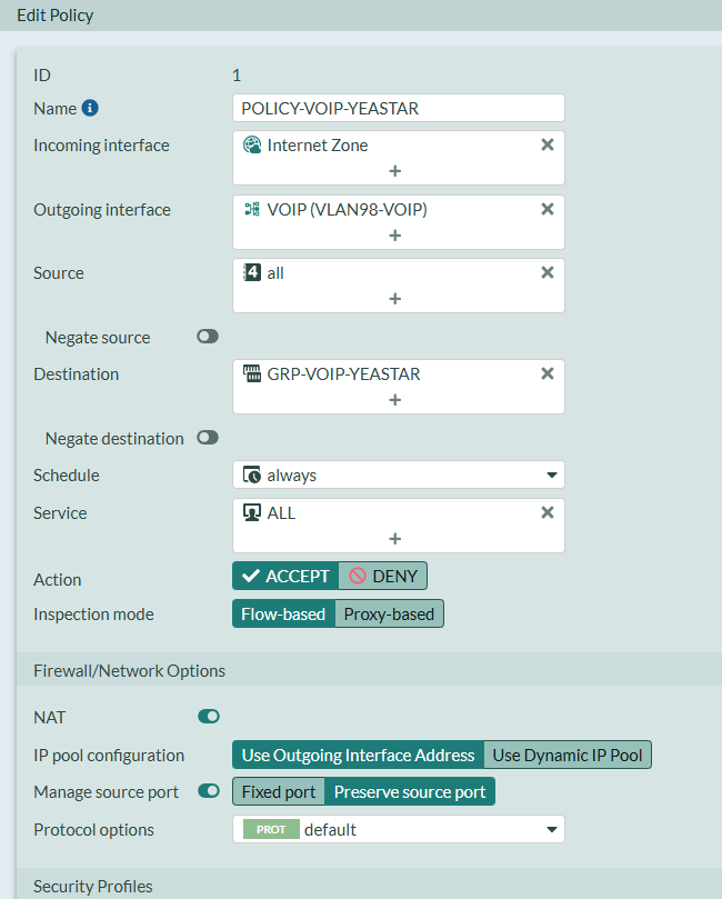

show firewall policy 1
- name: POLICY-VOIP-YEASTAR
- NAT: enable
- service: ALLshow firewall vip

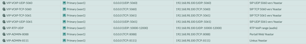

- VIPs for SIP 5060/5061 (TCP/UDP) and RTP 10000-12000 mapped to 192.168.98.100

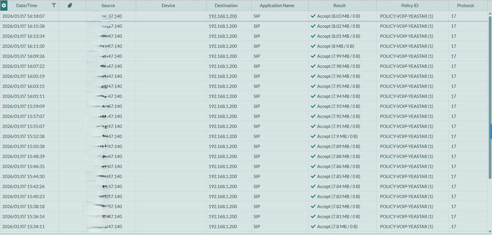

1 — Traffic logs show that SIP traffic is hitting the FortiGate and is being DNATed to the PBX (192.168.98.100) and accepted by firewall policy 1.

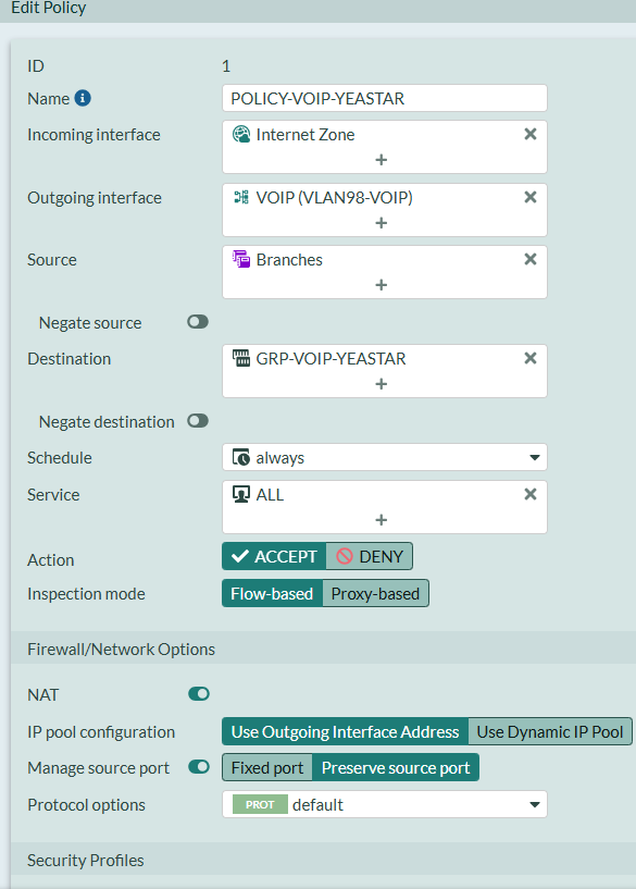

2 — Firewall policy configuration confirms NAT is enabled with Preserve source port (Fixed‑port), which avoids source port translation for SIP/RTP.
3 — VIP configuration confirms that SIP (5060/5061 TCP+UDP) and RTP (10000‑12000 UDP) are correctly forwarded to the Yeastar PBX, and VIPs are grouped under the same policy.
