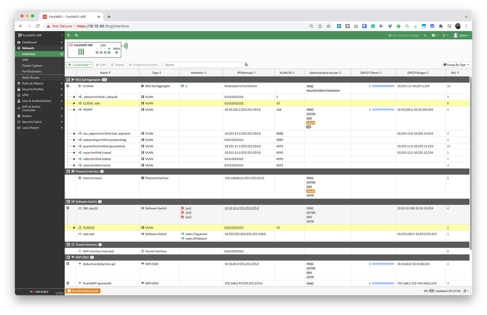

Here is another try to set this up, see screenshot.
However, in this setup it works as long as I connect to port 1-3 on the FGT but if I connect to a port on the FSW where there is another VLAN used with the same VLAN ID as Native VLAN, it does not work and the the host connected on the FSW doesn't get DHCP and has no access to the Internet...so the link between FGT and FSW does not propagate the VLAN domain between FGT and FSW...
I just can't get the FortiGate VLANs and the FortiSwitch VLANs to work together.
The FortiSwitch VLANs can't be used on the ports in the FortiGate and the VLANs on the FortiGate can't be used on the FortiSwitch. Creating a separate VLAN with the same VLAN ID on the FortiGate doesn't "bridge" the VLANs so that they work together, in my example here I have created a VLAN interface "CLIENT_FGT" with the same VLAN ID 10 as CLIENT VLAN that exists on the FortiSwitch. In this example I configured IP + DHCP Server on the FortiSwitch and that works ok and any devices connected to the switch has the access I define in policies. But if I try to add any FortiGate physical ports to the same VLAN by creating a software/hardware switch and then adding a VLAN with the same VLAN ID(can't use the CLIENT VLAN on the FGT unfortunately, have to create a new one with a different name and same VLAN ID...)
