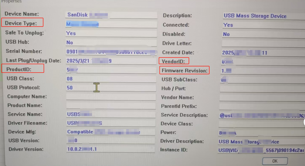

Hello, everyone. I have a question. The client ZTNA has 1,500 terminals, and each terminal may have two USB mobile devices. The client's requirement is to release them in a whitelist manner. However, with so many mobile terminals, the workload is a bit large. For the mice of the same brand purchased in the same batch, information such as USB Type, Vendor ID, Product ID, and Firmware Revision is still different.

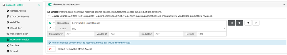

Good morning justin_zhan,
Hope you are well.
For sure, let me help you with your questions.
Question 1: Is there any way to avoid manual entry one by one? The workload is too large.
A: If you have different vendors, you will need to allow one by one or allow a Class instead.
Question 2: Can the whitelist be released based on a certain brand? For example, HP and Dell mice, Panasonic USB drives.
A: Yes, you can also use the Vendor ID, that should be the same.
Question 3: For the control of such a large - number of mobile external USB devices, are there any other good suggestions?
A: You can allow per Class, like HID, which stands for Human Interface Devices, that are Keyboards, Mice, Controllers and etc...
Hope this helps.
Have a great day!
