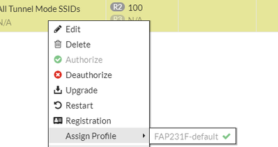

I had a look at the QSG for your model (https://fortinetweb.s3.amazonaws.com/docs.fortinet.com/v2/attachments/c03ec18a-01b9-11eb-96b9-005056...) could you confirm a couple of things?
1. Which LEDs are blinking blue as per page 4 in the guide? LED 4 will blink blue if only Radio 1 is in use.
2. Confirming that the default profile is what is applied to the FAP? Have you tried creating your own profile and applied it to the FAP?
3. Could you post the full output of show for the profile with any personal info removed?
4. Which FortiOS and FortiAP firmware versions are you using?
Hi,
1.fifth led - bluetooth is always on with amber colour
2. I have only one profile
4.Fortigate is 6.4.9 and FortiAP FP231F-v7.0-build0034
Hi Tutek,
As per the quick start guide (FAP-231F QSG) when LED 5 is orange it means that Radio 3 is turned on. In the case of the 231F, this would mean that the Dedicated Monitor has been enabled on radio 3. If BLE was enabled with radio 3 it would be green. Have a look inside your FAP-231F profile to verify that radio 3 is enabled.
Based on that I'd say that BLE is not turned on.
